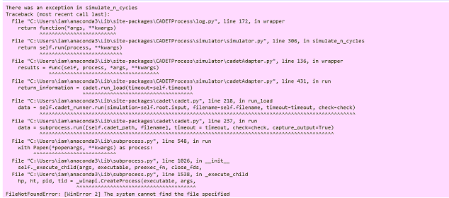

Hi Ron,
currently I am using CADET-Process 0.7.3 on Windows 10 Education N 22H2. I tried to use 0.9.1 but I got some other errors so I had to switch back. The code runs fine for me until the equilibrium constant.
Best
Nils
Hi Nils,
that might be the problem. What was the error in version 0.9.1? There have been many performance, feature and stability improvements since 7.3. so if at all possible I’d suggest to upgrade.
Yes, I would like to but when I did, I received this one for every simulation I ran:
GW_00001
Although I didn’t change the code at all. Is there something that changed the structure of the code?
Best
Nils
I can reproduce that error.
The problem is in this code section:
where you set the cadet_path using the cadet interface, and not the CADETProcess interface. Back in Version 0.7.3, CADETProcess just overwrote that setting and auto-detected the cadet_path itself. Now, it respects settings made to the cadet interface and crashes, because it tries to execute a directory.
You have two choices:
A:
Don’t set the cadet_path yourself. Just let CADETProcess figure it out itself. This will work well, as long as you don’t compile CADET core yourself because you need custom models.
B:
If you compiled CADET core yourself because you need custom models: set the cadet_path within the CADETProcess interface up until the cadet-cli.exe, like so:
from CADETProcess.simulator import Cadet
simulator = Cadet(install_path='/Users/nils.gehrmann/Anaconda3/bin/cadet-cli.exe')
