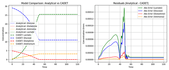

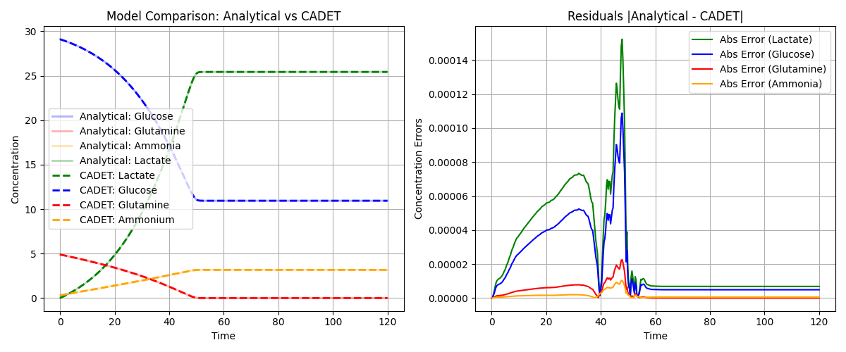

A case study has been implemented for a reduced form of the model Kontoravdi et. al (2005) doi.org/10.1016/S1570-7946(05)80173-7 describing cell population kinetics and cell metabolism. Equation 1-16 are included in this case study without consideration of the hill kinetics and without the influence of m_{GLC}.
Cadet_KontoravdiModel.zip (3.5 KB)
