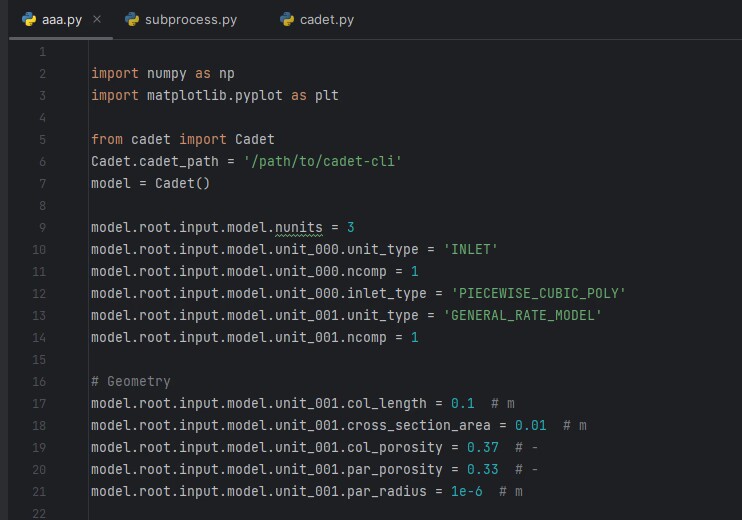

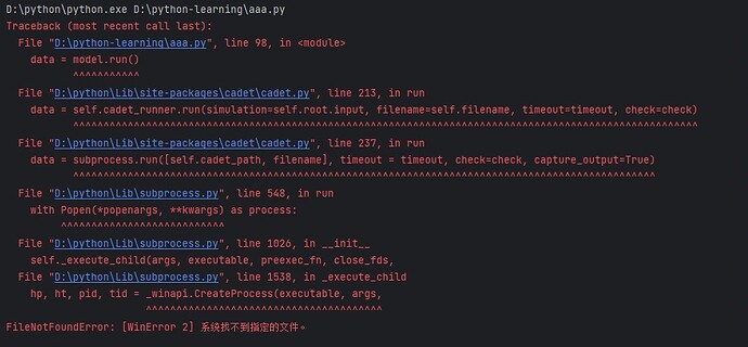

I am a newbie using cadet for the first time. I get an error when trying to run the code sample given in the cadet introduction, and I don’t know how to fix it.Here are some pictures and the wrong code

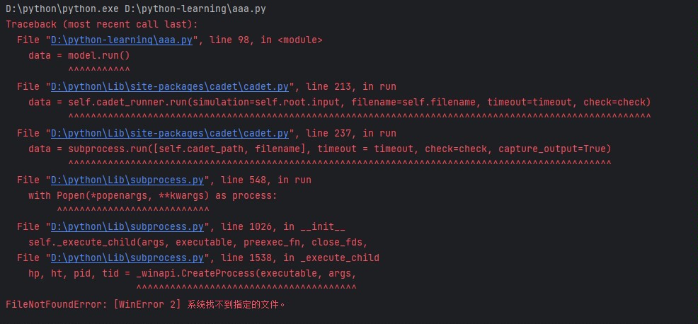

This error comes, because the line 6: Cadet.cadet_path = "path/to/cadet-cli" needs to get replaced with the actual path to the cadet-cli, as installed on your machine.
