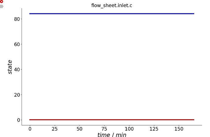

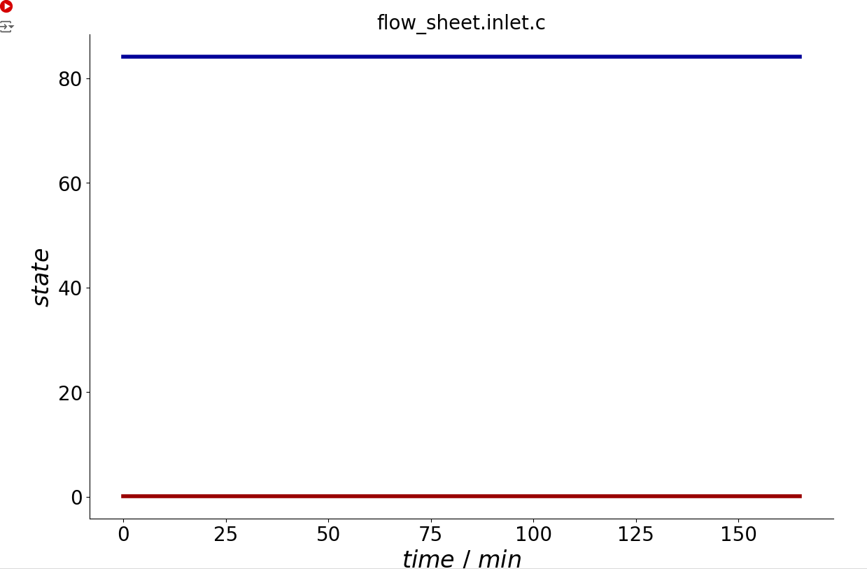

Additionally, i have encountered a ā€˜file not found error’ while plotting simulation results where it requires importing cadet from cadet_process module in the same code.
The respective code is as follows:
from CADETProcess.simulator import Cadet
process_simulator = Cadet()
The error:
FileNotFoundError: Could not autodetect CADET installation. Please provide path.
For which, i uploaded the cadet files on colab and provided respective path as follows:
process_simulator = Cadet('/content/sample_data/CADET-0.10-py3-none-any.whl')
still the process persists even with other .tar.gz file
I am getting a plot as output even with this error

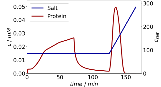

which is far from desired plot as follows produced by @l.thiel in one of his replies which was
Below is code provided by him with changes as suggested by you
import numpy as np
from CADETProcess.processModel import ComponentSystem
from CADETProcess.processModel import StericMassAction
from CADETProcess.processModel import Inlet, GeneralRateModel, Outlet
from CADETProcess.processModel import FlowSheet
from CADETProcess.processModel import Process
# Input Model
c_salt_low = 84.105
c_salt_high = 288.58
c_protein = 0.029
# Component System
component_system = ComponentSystem()
component_system.add_component('Salt')
component_system.add_component('Protein')
# Binding Model
binding_model = StericMassAction(component_system, name='SMA')
binding_model.is_kinetic = True
binding_model.adsorption_rate = [0.0, 4.35E-31]
binding_model.desorption_rate = [0.0, 1.00E-22]
binding_model.characteristic_charge = [0.0, 14.000]
binding_model.steric_factor = [0.0, 261.000]
binding_model.capacity = 710
# Unit Operations
inlet = Inlet(component_system, name='inlet')
inlet.flow_rate = 2.83e-9
column = GeneralRateModel(component_system, name='column')
column.binding_model = binding_model
column.length = 0.05
column.diameter = 0.15e-2*2
column.bed_porosity = 0.47
column.particle_radius = 3.25E-05
column.particle_porosity = 0.23
column.axial_dispersion = 3.9e-7
column.film_diffusion = [2.0e-5, 1.0e-5]
column.pore_diffusion = [7e-5, 5.5e-12]
column.surface_diffusion = [0.0, 1.38E-15]
column.c = [c_salt_low, 0]
column.q = [binding_model.capacity, 0]
outlet = Outlet(component_system, name='outlet')
# flow sheet
flow_sheet = FlowSheet(component_system)
flow_sheet.add_unit(inlet)
flow_sheet.add_unit(column)
flow_sheet.add_unit(outlet)
flow_sheet.add_connection(inlet, column)
flow_sheet.add_connection(column, outlet)
# Process
process = Process(flow_sheet, 'lwe')
process.cycle_time = 9898.902
## Create Events and Durations
wash_start = 4232.598
gradient_start = 7407.137
concentration_difference = np.array([c_salt_high, 0.0]) - np.array([c_salt_low, 0.0])
gradient_duration = process.cycle_time - gradient_start
gradient_slope = concentration_difference/gradient_duration
process.add_event('load', 'flow_sheet.inlet.c', [c_salt_low, c_protein])
process.add_event('wash', 'flow_sheet.inlet.c', [c_salt_low, 0.0], wash_start)
process.add_event(
    'grad_start',
    [[c_salt_low, gradient_slope[0]], [0, gradient_slope[1]]],
    gradient_start
process.plot_events()
process_simulator = Cadet('/cl')
simulation_results = process_simulator.simulate(process)
from CADETProcess.plotting import SecondaryAxis
sec = SecondaryAxis()
sec.component_indices = [0]
sec.y_label = '$c_{salt}$'
simulation_results.solution.column.outlet.plot(secondary_axis=sec)
