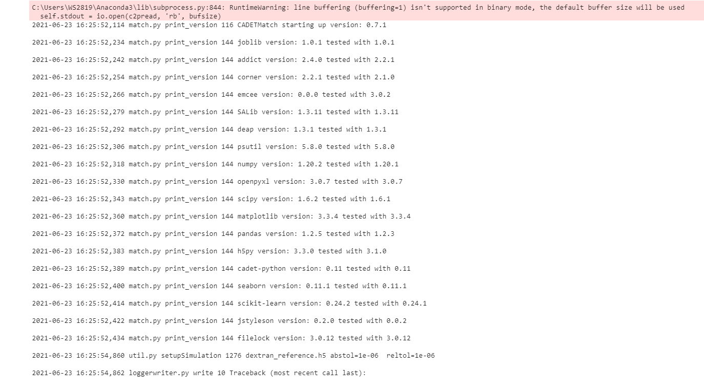

Hey everyone,
while getting familiar with CADET using the extremely helpful Tutorial provided by you guys
I noticed, the 01_CADET-Match_demonstration wasn´t generating any parameters for me.
after running “match.start_sim()” my output was:
But the result, progress and error csv-files were still empty afterwards. (In the meta folder as well)
The command “match.plot_corner()” didn´t do anything for me
and the command “match.plot_best()” resulted in the following index Error:
The same Problem is also occurring when executing those commands in 02_CADET-Match_exercise as well.
Has this Problem occurred for anybody else?
Does anyone know how to fix it?
Thanks in advance for your help.

and see if that fixes the error? The python cadet interface was just renamed from cadet to cadet-python and I suspect that is what is causing problem.

This is really odd and so far I have not been able to replicate it. Can you run the follow block of code in your notebook? Just put it in the top cell.
import cadet
print(cadet.__file__)
print(cadet.__version__)

The output for your command is:
C:\Users\WS2819\Anaconda3\lib\site-packages\cadet_init_.py
0.4

this time it displayed my emcee-version to be 0.0.0 although it clearly got installed in the last step of the installation before the safety error occurred.
maybe this is also related to my problem

On a side note: is the RuntimeWarning
C:\Users\WS2819\Anaconda3\lib\subprocess.py:844: RuntimeWarning: line buffering (buffering=1) isn't supported in binary mode, the default buffer size will be used
  self.stdout = io.open(c2pread, 'rb', bufsize)
I encountered something that usually occurs, or does this indicate additional installation mistakes?
No problem I am happy everything is working now.
You can ignore this warning. It just comes from running the matching software inside jupyter notebooks.
