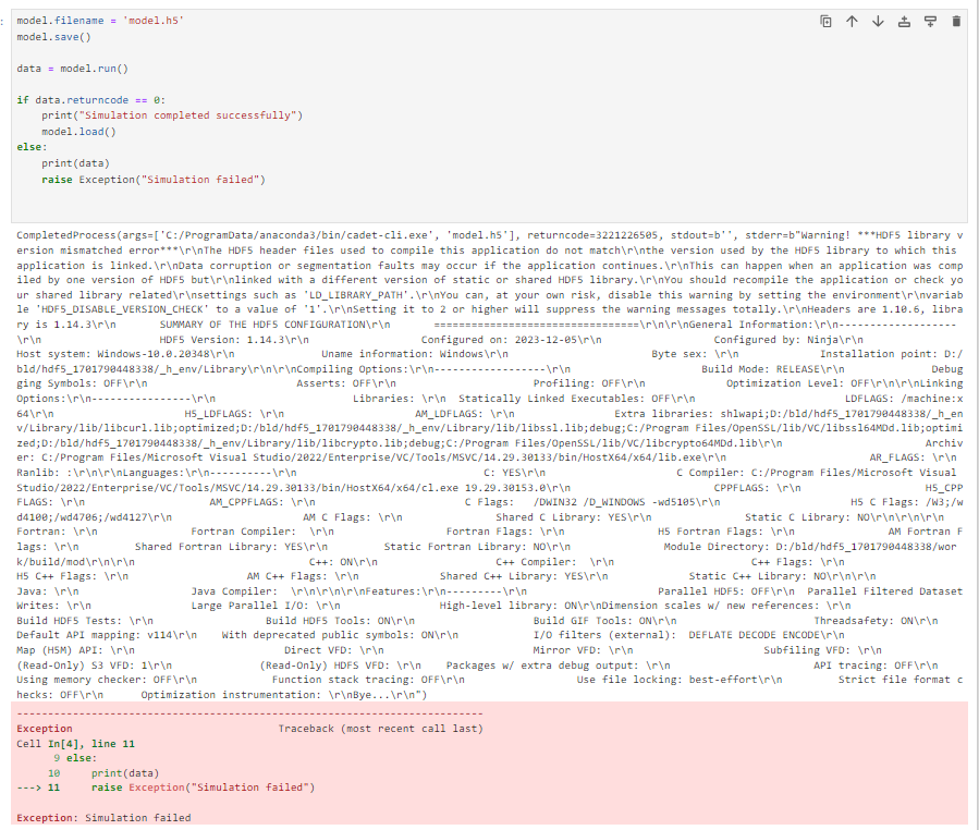

I am following the CADET introduction tutorial and am getting three system errors missing the following dll:
liblapack.dll
umfpack.dll
libblas.dll
The code then says:
CompletedProcess(args=['C:/ProgramData/anaconda3/bin/cadet-cli.exe', 'model.h5'], returncode=3221225781, stdout=b'', stderr=b'')
Exception Traceback (most recent call last)
Cell In[4], line 13
11 else:
12 print(data)
---> 13 raise Exception("Simulation failed")
Exception: Simulation failed

Hi again
So, I uninstalled h5py and installed version 3.6.0, but the mismatch error persists.
Warning! ***HDF5 library version mismatched error***
Headers are 1.10.6, library is 1.14.3

I am still getting the mismatched error and don’t know what else to try. I am on python version 3.10 as recommended.

Hey,
with the environment specified above I cannot reproduce the error.
But I did notice, that h5py is missing in your environment.
So apparently there was some problem with the installation of h5py.
I would suggest you join us at the next office hours , next week wednesday.
Shubhra
January 30, 2024, 11:29pm
9
I have installed h5py version 3.6.0 but am still getting the mismatch error. I’ll join office hours next week and get some hands-on help!
Thank you for your time.
