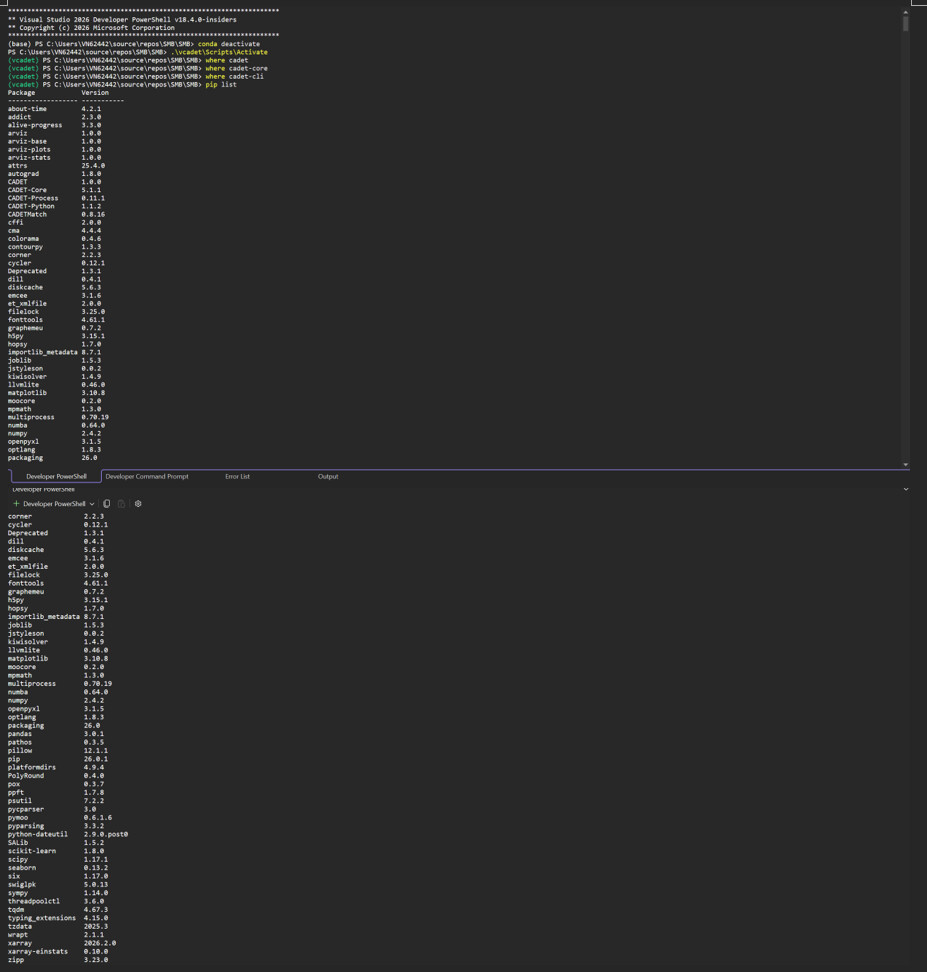

The screenshot above is the “where” commands and pip list output. I just merged 2 screenshots together because I do not know how to transfer the output from VS2026 to a .txt file :sweat_smile: .

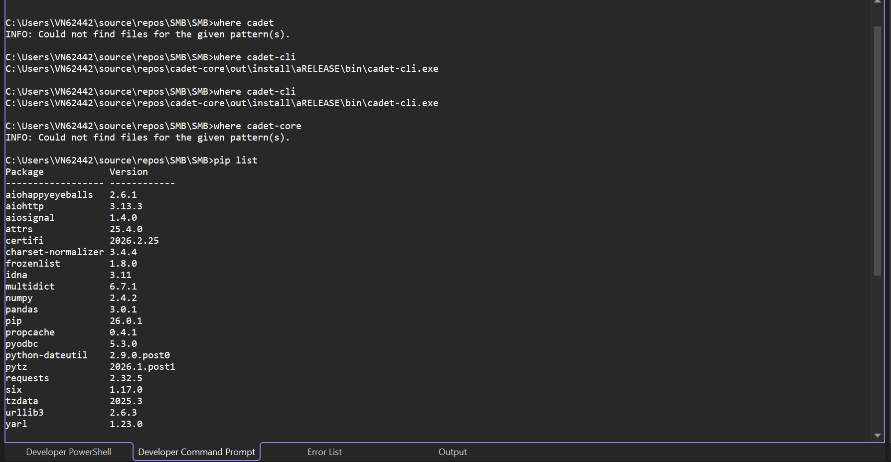

The pip list looks alright, the “where” command unfortunately didn’t print any outputs, since you are in the power shell. Can you possible use the Command Line Interface (CMD) instead and repeat the commands?
I will have a look at how the autodetect interacts with the CADET-Core package in the meantime.

This cmd output is after I activated vcadet in PowerShell.

That exactly confirms my suspicion.
At some point, the path to cadet-cli was added to your global PATH environment variable. Because of that, it appears when you run where cadet-cli. CADET-Process detects the executable built from source on the PATH and assumes that this is the default CADET installation you want to use.
This behaviour is intended and not a CADET issue. The PATH variable is controlled by the user, and any executable placed there will be detected automatically.
Also note that if you are not working inside an isolated environment (e.g., a conda environment or a Python venv), this can easily lead to the issue you are seeing. On Windows you effectively only have one global PATH, which means you can only have one CADET installation reliably available via cadet-cli at a time. If multiple CADET installations exist on your system, the one that appears first on the PATH will be used, which may not be the one you intended.
