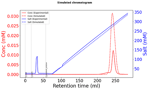

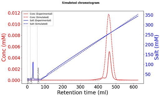

I’m fitting an SMA + LumpedRateModelWithPores on an AKTA-generated LGE data with low loadings with CADET-Process. I’m currently not using reference concentrations as I want to see if I can re-use the previously fitted parameters from GoSilico/ChromX, which produced a very good simulation. I have verified that the Yamamoto’s results from both GoSilico & CADET-Process are in agreement. Other parameters (axial dispersion, film diffusion, etc…) are copy-pasted with proper unit conversions from GoSilico.
Using these Yamamoto-fitted parameters (k_eq, charge, steric factor), the elution peaks are in the right time position, but the height is approximately 2-3 times the actual data, and there seems to be peak broadening.
Just from your general curve-fitting experience, which other parameters could be re-fitted to adjust the simulated curve heights? Or should I just re-fit the whole model from scratch with inverse-fitting / CADET-Match?

What does the fit with ChromX look like?

Due to conservation of mass, the injected mass must be the same as the eluted mass (assuming that everything comes off the column). The simulated chromatogram has a much greater mass than the experimental one.
Like @s.leweke said, it is critical that we check the mass balance (mass loaded must equal mass eluted for 100% recovery). A common issue when fitting experimental data is not accounting for UV detector nonlinearity and saturation. You can check the mass balance for your experimental data, and if you find that there is less in elution then that is your issue.
