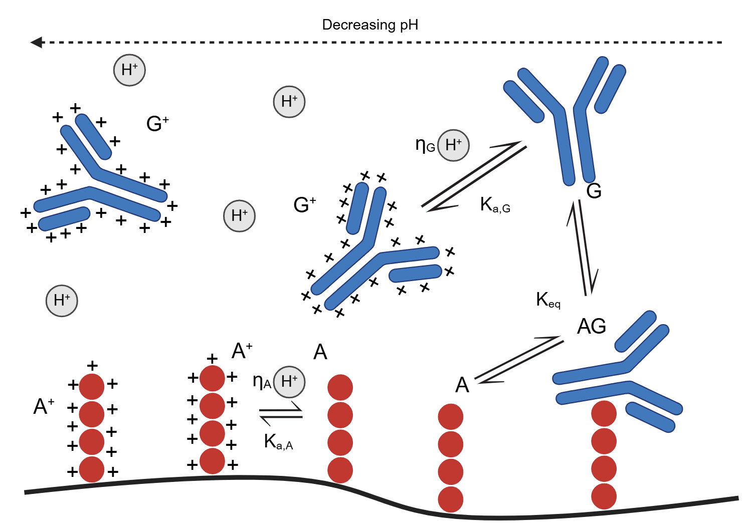

According to the binding model feature matrix, the Langmuir LDF doesn’t have the mobile phase modifier option, but it sounds like you’re basically asking about a Mobile Phase Modulator Langmuir binding model. I am not sure if there’s a reason you’d want to use the Langmuir LDF specifically, but if it’s just to use Keq you can do that by setting K_d to 1 and use K_a as the K_eq. However, as it is implemented, the functional form for parameter dependence may not be what you need.
I’m not sure if there’s another way to do what you’re asking (maybe something with the Generalized Ion Exchange model?), and I can’t be of much help as I have just relied on the existing implementation of the colloidal isotherm for pH dependence so far, but I think the Mobile Phase Modulator Langmuir isotherm would be the most equivalent to that approach. However it might need to be modified to get the pH dependence right.

I think you will need to use external functions if you want to use the pH-dependent Langmuir. Like @a.moser said, the colloidal model should also work. That one will not require external functions. I think the colloidal model is implemented using LDF. So the colloidal is probably the most sensible here.

You could also try the ACT isotherm in this post:
It will be available in the next release shortly.
One problem with mobile phase modulator Langmuir is that it cannot model q_{max} changes as a function of pH. ACT isotherm is capable of doing it.
